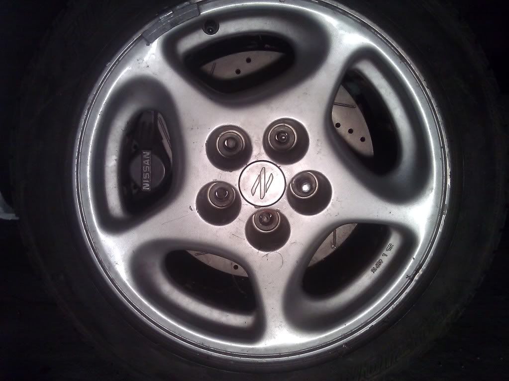

Message It almost does, we are looking at what configuration ( spacer and shaving of caliper ) we would have to do to get it to work ( if it can work ). If it will work it will only do so with a TT rear wheel, we tried a front wheel and was not able to bolt the wheel on.
With the TT wheel on the "Humps" on the wheel hit the caliper. But the wheel can move between the humps. Once we are able to get a few sets on 5mm spacers we will have a definite answer on "IF" it is possible with our kit.
